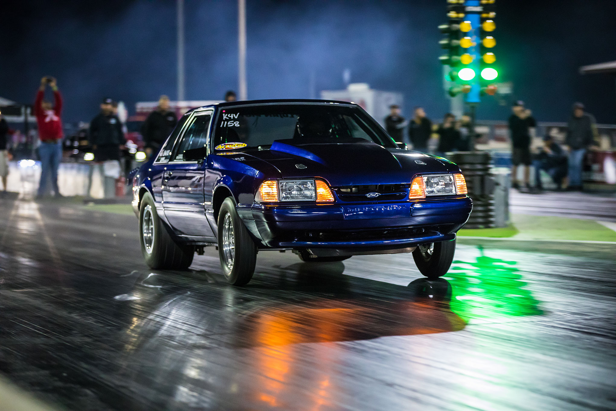

David Carpenter is a racer. The 38-year-old parts manager from Lake Worth, Florida is the proud owner of the amazing '92 Mustang you see here. While some of you may look at this and cry trailer queen, the fact of the matter is this is just as much a street car as it is a racecar. Sure, it may lean a little more to the racecar side, but the license plate isn't just for looks.

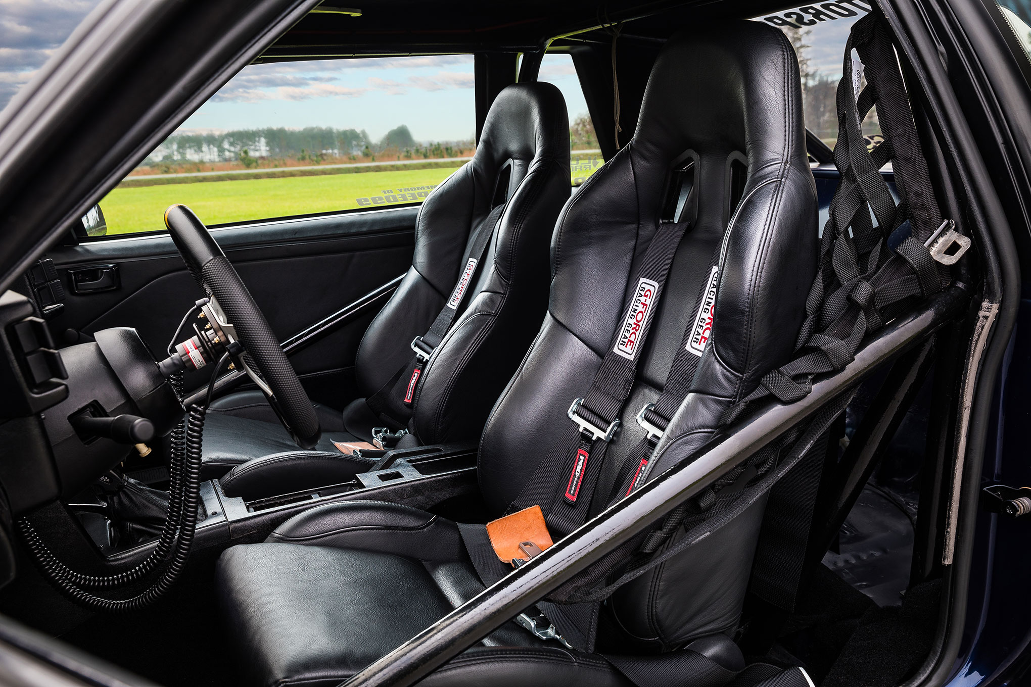

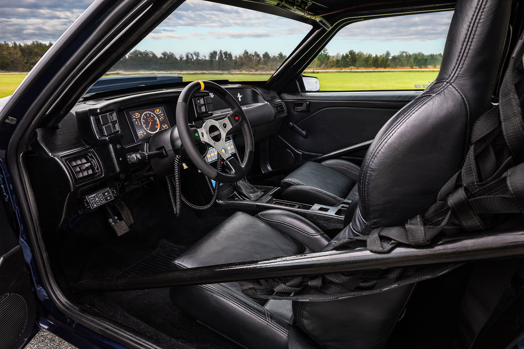

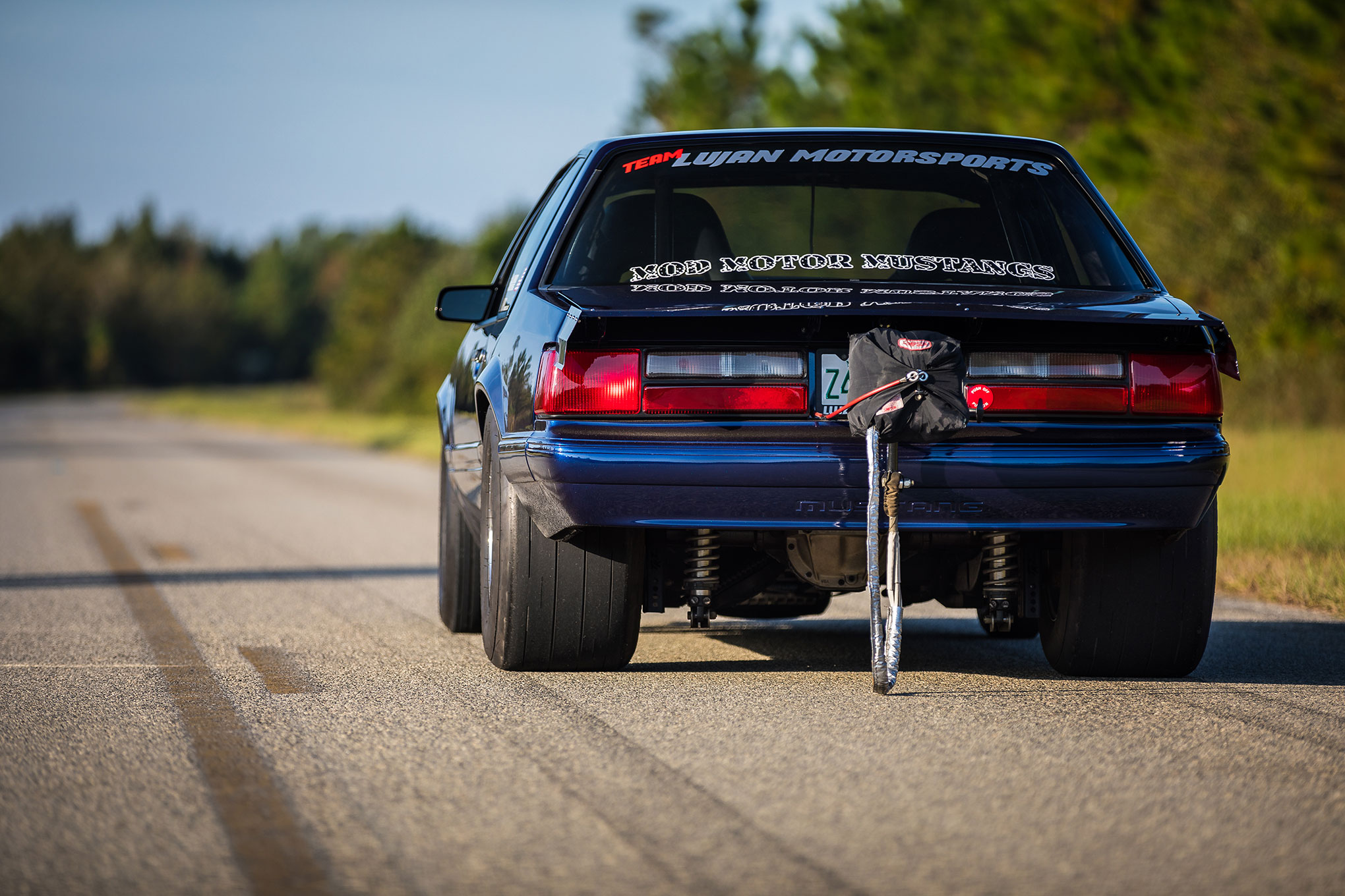

With the engine bay complete, David turned his attention to the rest of the car. With the interior stripped, the chassis work and roll cage were installed. The 10-point cage fortified the chassis, while being designed to keep David safe in the event something happened at a high rate of speed. The car was then mini-tubbed to allow for extra real estate for larger rear tires. After all, traction is important! To that end, the right suspension components were needed to harness the power David had planned. For this, he turned to the experts at UPR Products. He needed suspension components there were not only strong, but also lightweight. UPR specializes in chromoly suspensions components designed for the abuse of both the track and the street. This made them the perfect choice for this soon-to-be rocket ship. David installed UPR's Pro Series K-member and A-arms, subframe connectors, and adjustable upper and lower rear control arms. The rear suspension was finished with a UPR antiroll bar to keep the car flat and level during hard launches.
The front suspension was completed with a set of Viking Crusader struts. The rear suspension uses a set of QA1 double-adjustable shocks. The rearend housing is a modified 8.8-inch unit, with a Moser 35-spline spool and axles, and 3.55 gears.

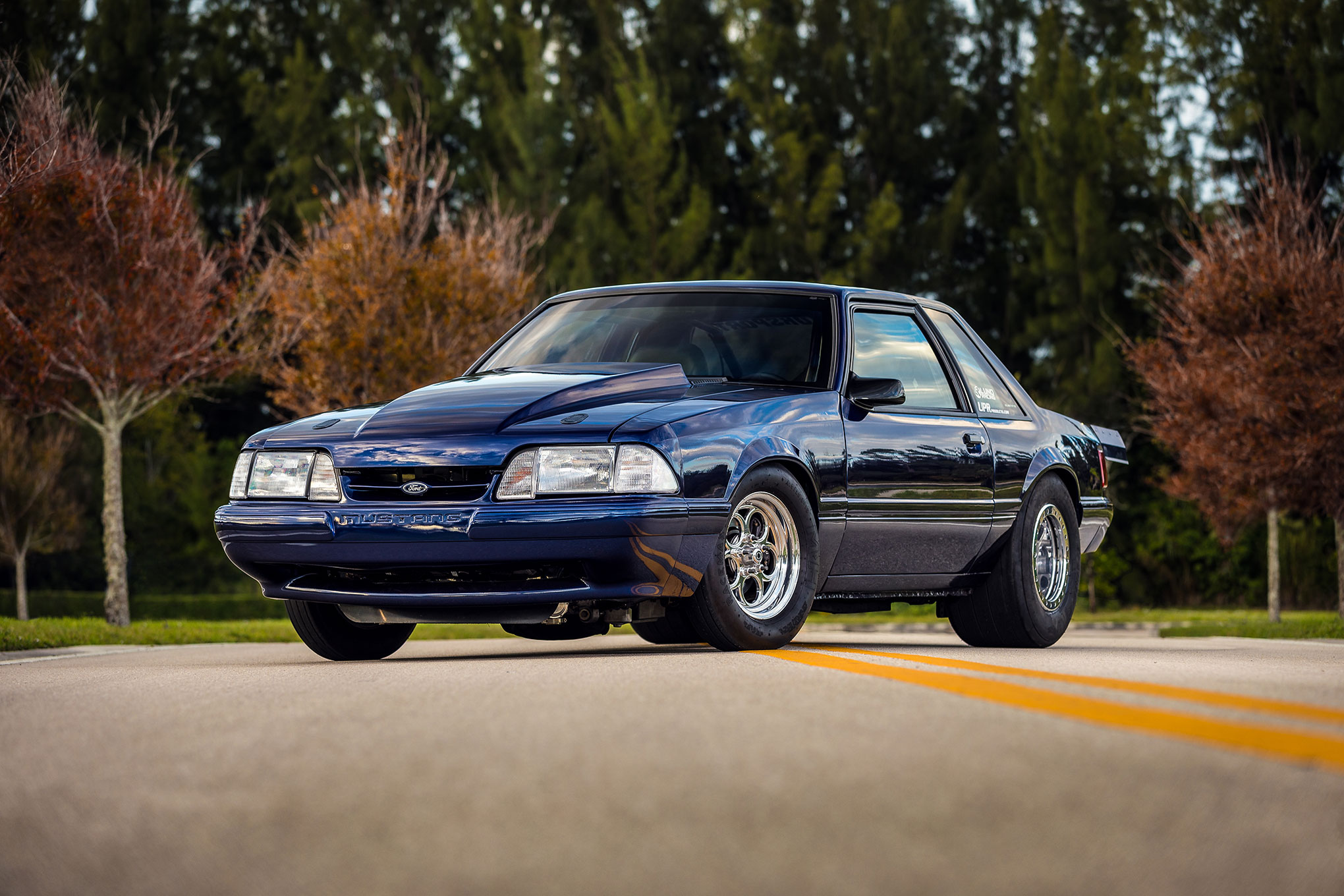

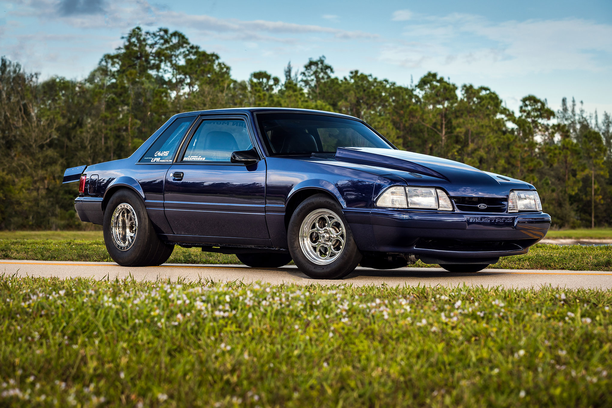

With the restoration nearing completion, the aesthetics became the focus. Color was important, and David picked Ford's Kona Blue. The deep blue gave that car a classy look and allowed it to stand out among other Foxes. Rob Acevedo of Naples, Florida, laid down the paint and he knocked it out of the park! The truly impressive part is the car was painted in a tent in Rob's backyard.

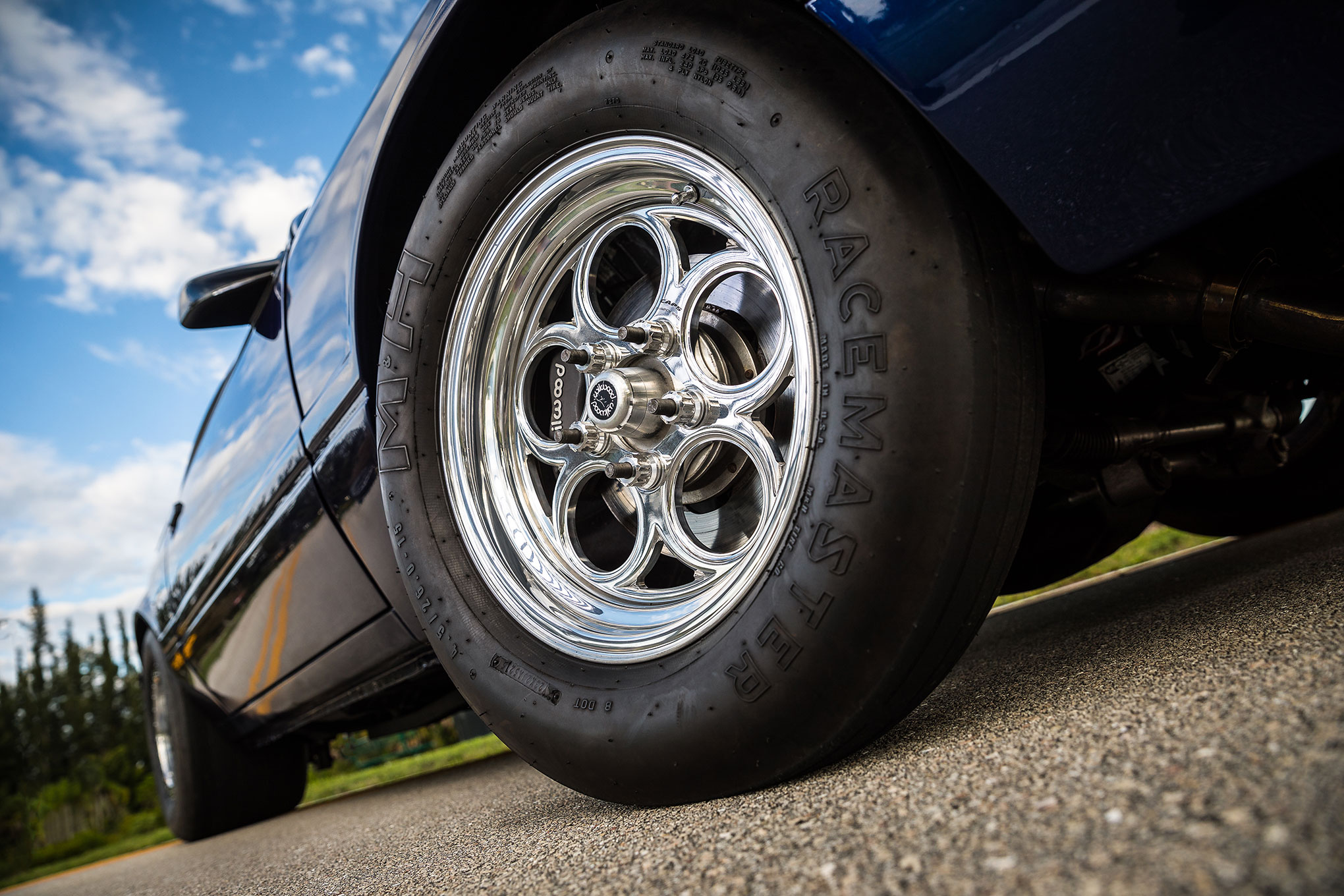

Another important aspect of any project are the wheels. When it came time to pick rolling stock, David decided on a set of Champion wheels. A pair of 15x3.5 wheels with M&H tires resides up front, while 15x12s with 325/50R15 Mickey Thompson ET Street Rs live (for a short time at least) in the rear. A mix of Wilwood and Moser brakes sit in the corners and do a stellar job of bring the fun to a halt when needed.

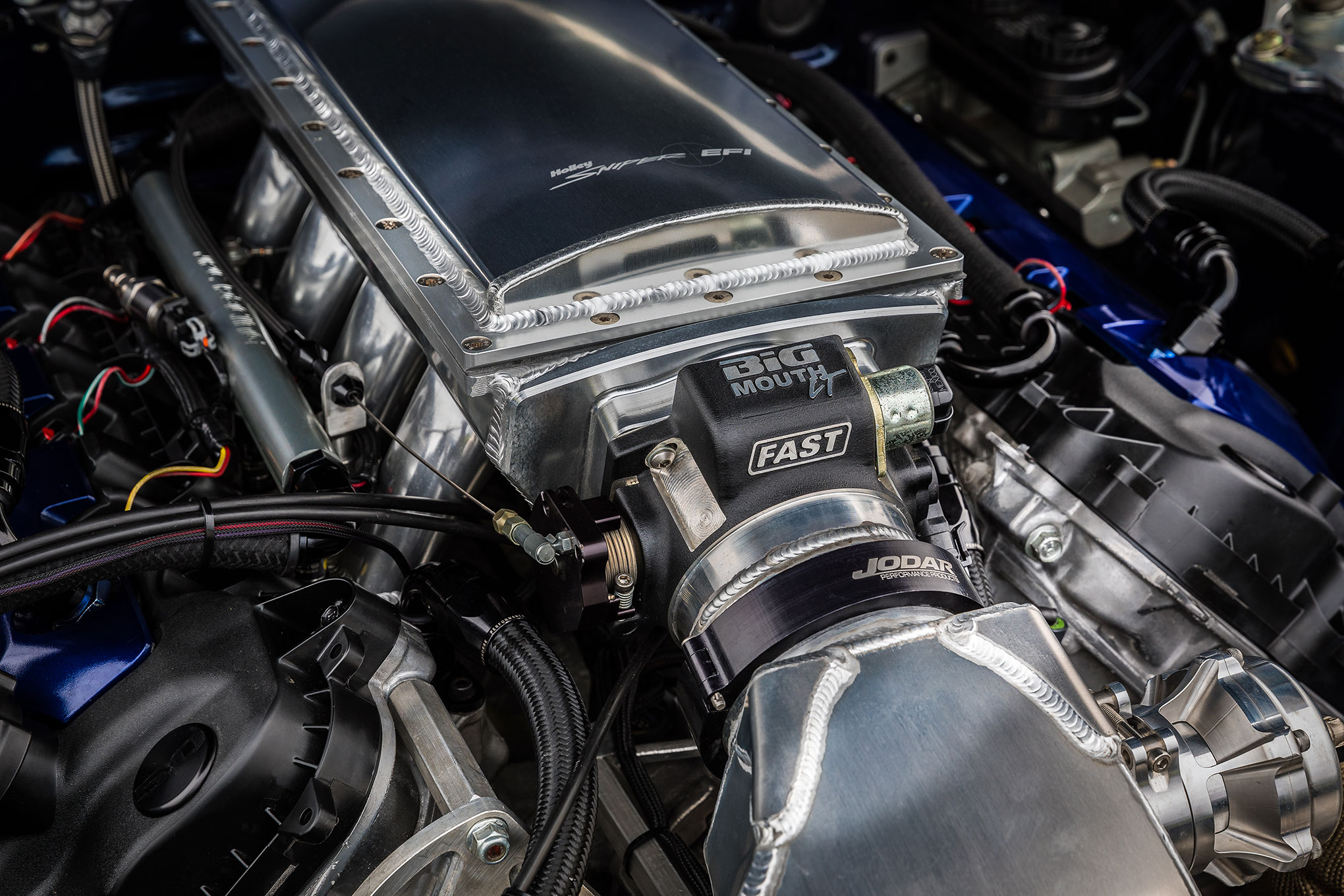

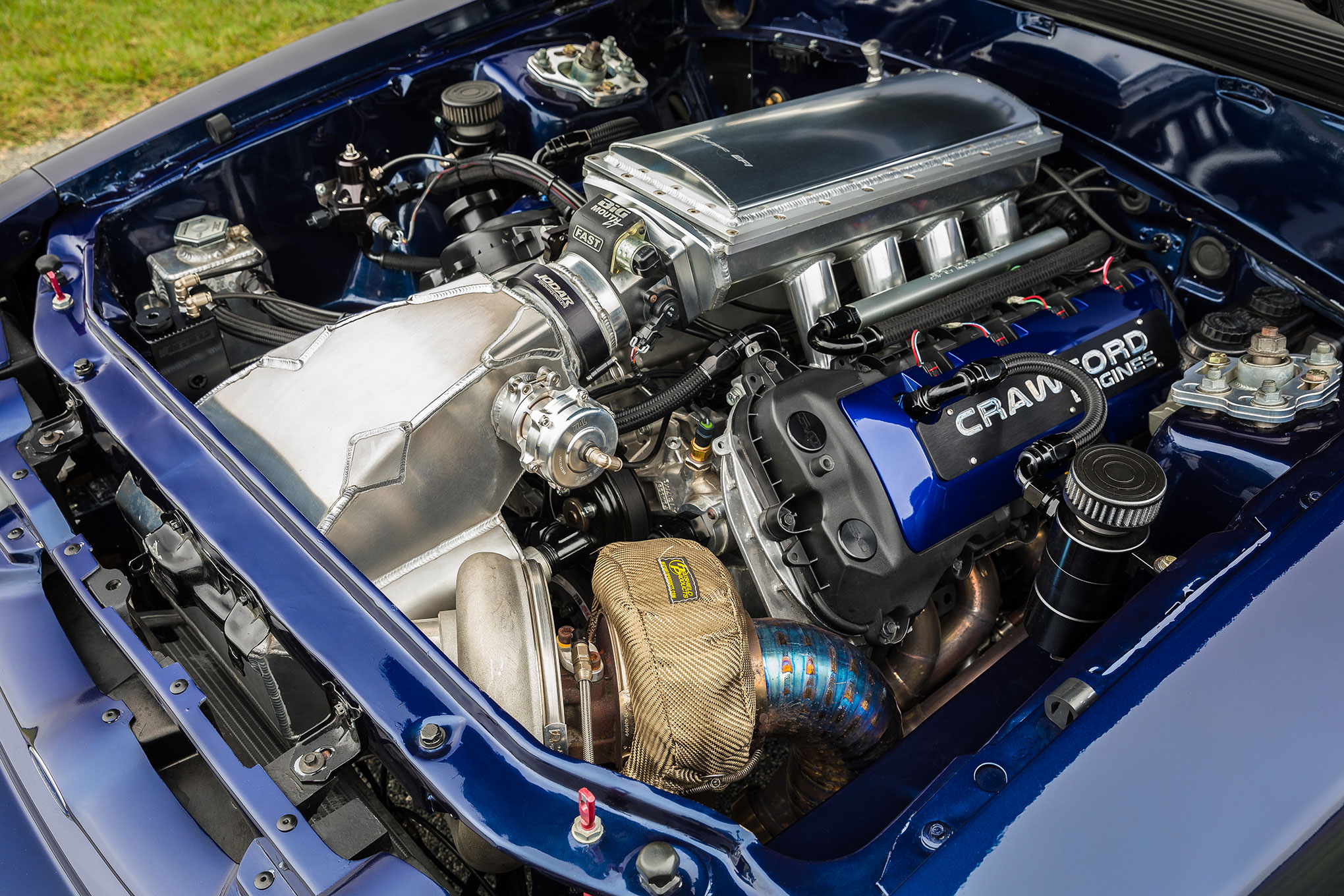

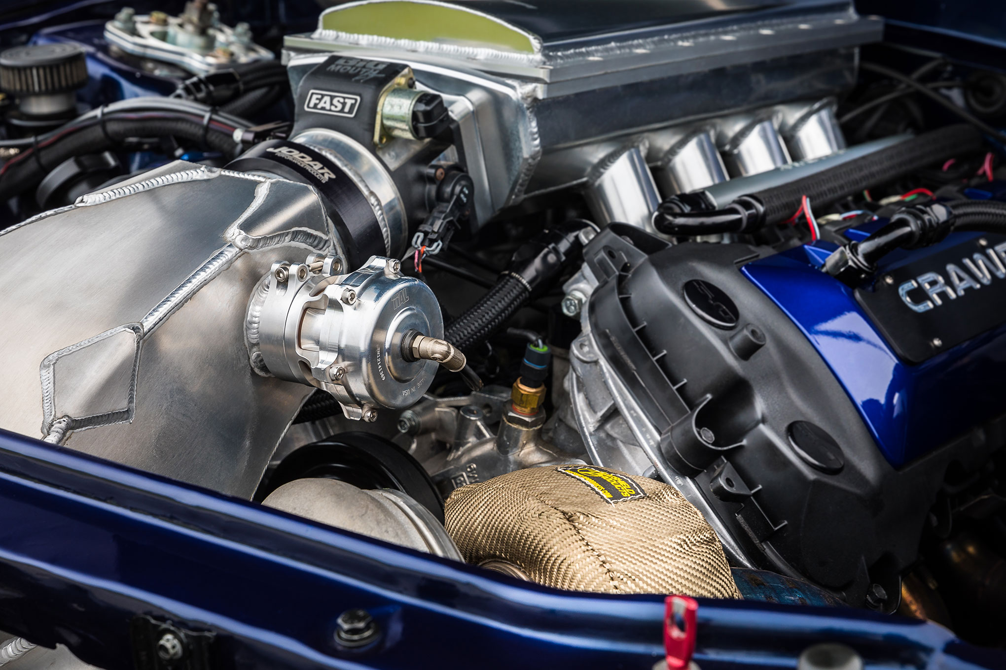

For power production, David turned to Ronnie Crawford in Miami, Florida and the build began. The engine started life as 2014 Mustang GT engine, but little would remain from its original form. The stock rotating assembly was replaced with a Boss crankshaft, Oliver billet steel rods, and Wiseco pistons. The displacement received a bump from 302ci to 305ci with a boost-friendly 9.5:1 compression ratio. The factory cylinder heads were sent to Tim Eichhorn at MPR Racing Engine in Boynton Beach, Florida. There, the factory valves were removed in favor of a set of from Ferrea. These would be able to handle the increased heat seen when 30 pounds of boost would be introduced into the engine. The valve springs were upgraded and a set of custom billet camshafts were installed. Soon the cylinder heads were reunited with the short-block, and the engine neared completion. A Holley Sniper Race intake manifold with a FAST 87mm throttle body completed the engine. A Cobra Jet oil pump and a Moroso oil pan ensured oil would be distributed to all the right places, even under the extreme forces seen at the race track.

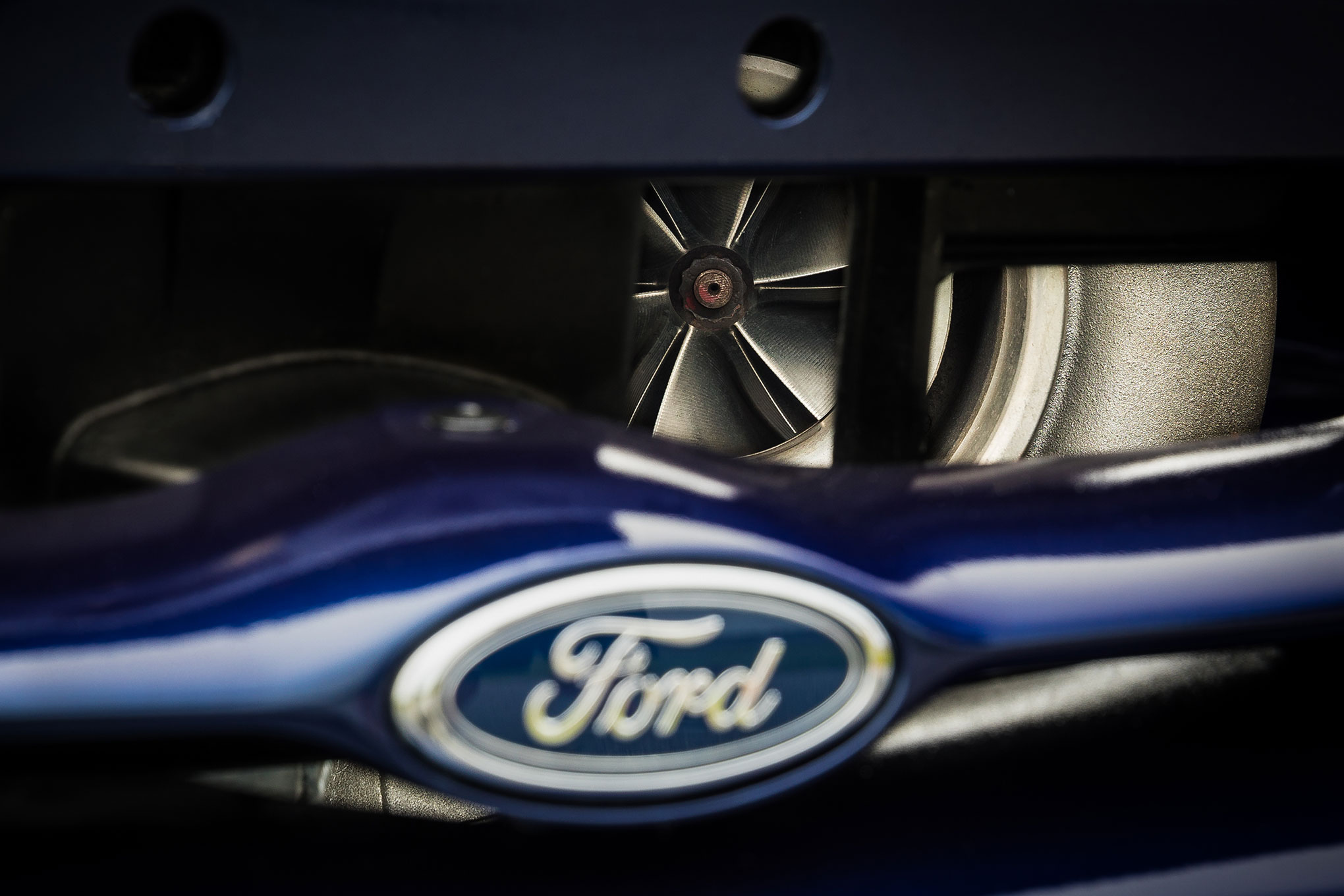

Boost is a wonderful thing. If you've never had the chance to experience a fast turbo car, we highly recommend it. David shares our feeling on the topic, and employed an 82mm turbocharger from Precision Turbo and Engine to force feed air into the Coyote. The incoming air charged is cooled by a custom built air-to-water intercooled. The entire turbo kit (including the intercooler) was built by Kevin Konchan, it is truly a work of art!
When it came to controlling the engine, David installed a Holley EFI system. The standalone is tuned by John Lund, Jr. at John Lund racing. While exact number were kept secret, we're told the combination made around 1200 horsepower.

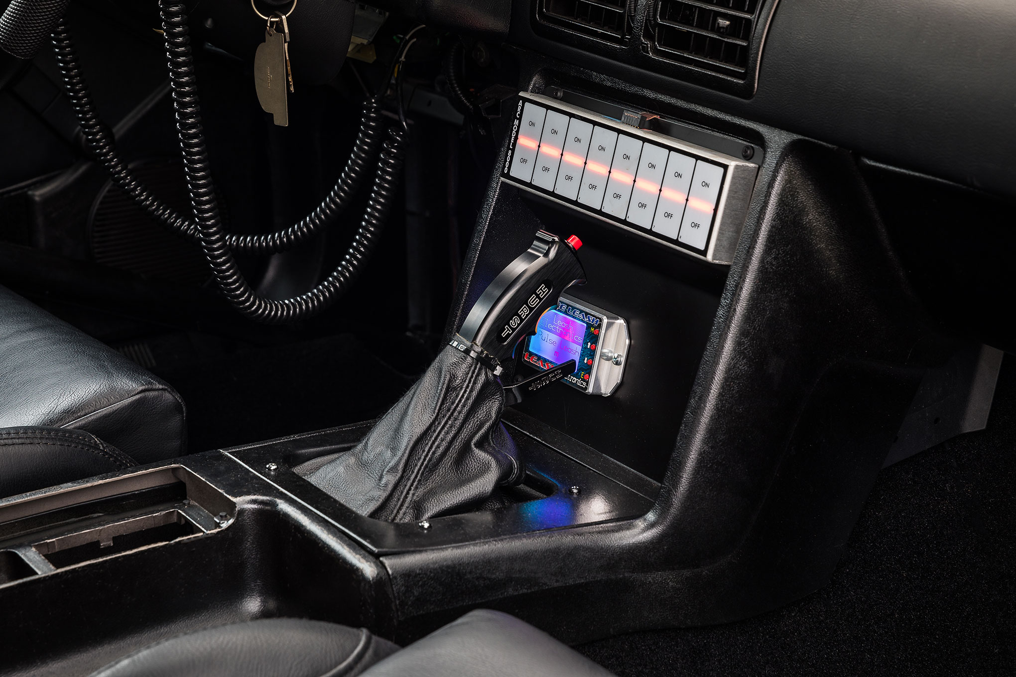

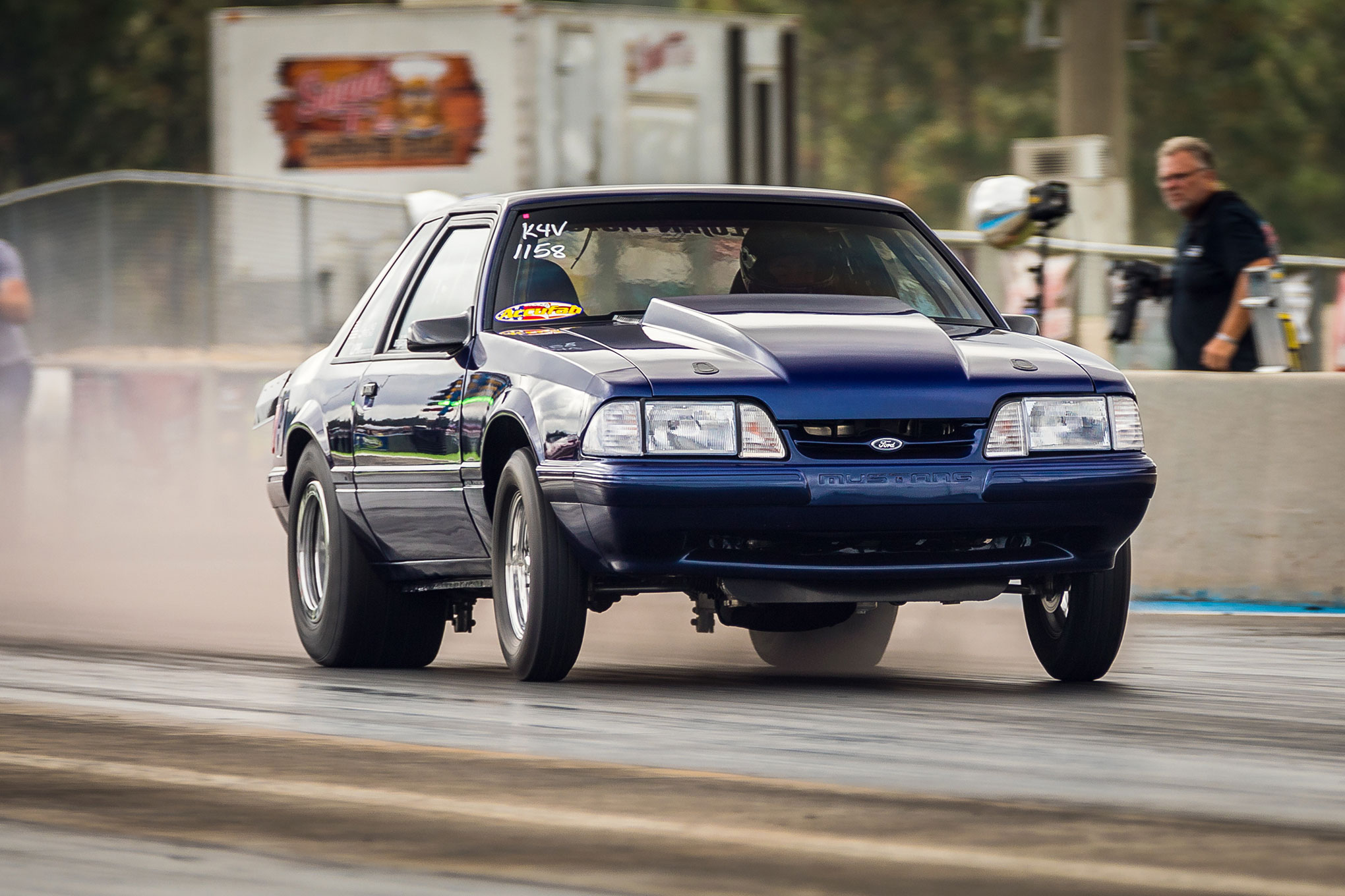

Transferring 1200hp through the drivetrain is no small feat. Especially considering the car sees as much street time as it does track time. To handle this much horsepower, David went with a tried-and-true combination from JPC Racing. A bolt-together Neil Chance torque converter transfers power to the JPC spec'd Powerglide from Transmission Specialties. An aluminum driveshaft turns the pinion in the rearend.

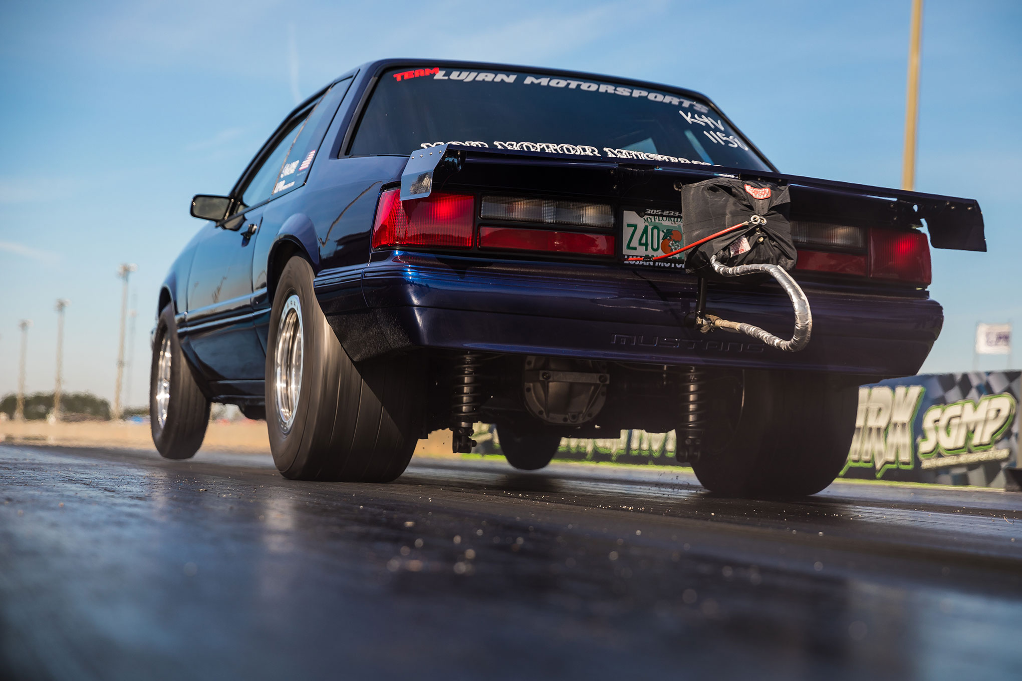

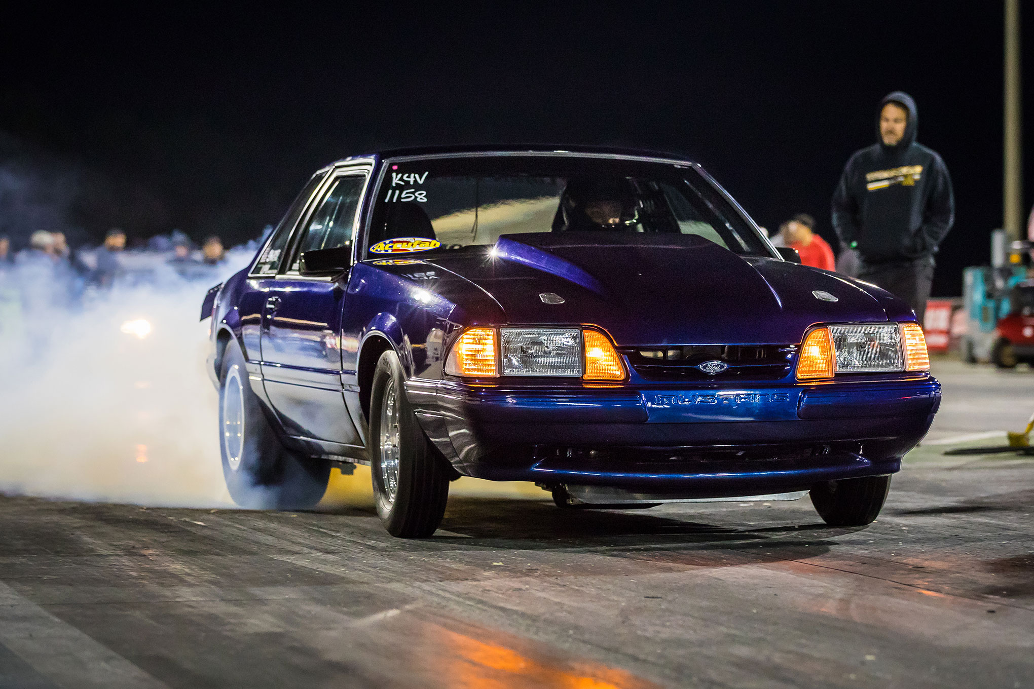

When it all came together, you got an absolutely stunning blend of power and beauty. This turbo Coyote Fox have been a best E.T. of 7.72 seconds at 174 mph. And if that isn't impressive enough, it traversed the first 60-feet of the track in a blistering 1.16 seconds!
